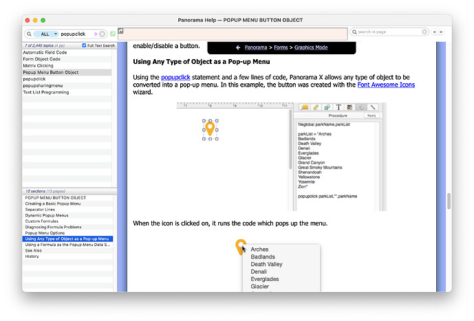

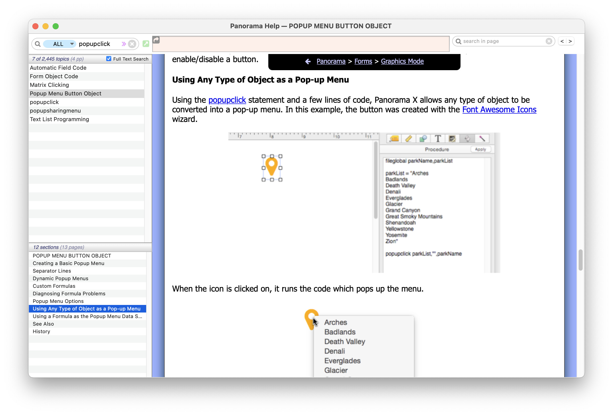

If you just want to run code, and donāt need to have the menu associated with a field or variable, itās usually simpler to just use a push button (or any kind of object, even a rectangle or other shape) and use the popupclick statement to generate the menu. This is described in a subsection of the Popup Menu help page.
I used this method and it works great. Used the example in the documentation. Used the example suggested by @epansoft to call procedure.
Also, thanks to @pcnewble for examples for use of custom menus.
Thanks to all.
Follow-up question. This is some of the documentation for popupclick:
āYou can also use the menu( and menuitem( functions to create the menu, as shown in this example. This is more complicated but gives you more control ā you can give menu items different colors or styles, or even include submenus in your pop-up menu.ā
I found some old discussions related to submenus that said it didnāt work. Can submenus be used on buttons using popupclick? Just want to make sure before I continue testing.
