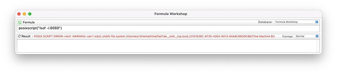

Apparently on Robert’s system this shell command produces an error. I have no idea why, especially since the error message seems to have nothing to do with port 8080.
Robert submitted this error message privately to me some time ago, so I’ve made a change for the upcoming version of Panorama. Panorama still runs lsof when starting the server, but now it checks for an error. If an error occurs, Panorama just ignores it and proceeds to launch the server without verifying that the port is available (like it did for b25 and earlier). I don’t know of any other way to check for a port being in use, so this is the best I can do.
So, you can see why I say this message isn’t really related to Panorama X Server. At the time this error message appears, Panorama X Server hasn’t even been launched yet.
Robert, until the next version comes out, I think you’ll have to go back to b25. Or, if you can figure out why lsof fails on your system and correct, it, you’ll be able to continue to use this version. It might be illuminating to find out what happens if you run lsof in Terminal.app.
Automation-21:~ rameeti$ lsof -i:8080
lsof: WARNING: can’t stat() smbfs file system /Volumes/.timemachine/FasTrak._smb._tcp.local./31D1638C-8735-40EA-9413-84A8C88D6CB8/Time Machine BU
Output information may be incomplete.
assuming “dev=36001ec6” from mount table
COMMAND PID USER FD TYPE DEVICE SIZE/OFF NODE NAME
PanoramaX 72460 rameeti 6u IPv4 0xa8708ea5f97fcd47 0t0 TCP *:http-alt (LISTEN)
PanoramaX 72460 rameeti 7u IPv6 0xa8708e9c5ff3a48f 0t0 TCP *:http-alt (LISTEN)
PanoramaX 72460 rameeti 22u IPv4 0xa8708ea5f97f02a7 0t0 TCP 192.168.1.16:http-alt->94.232.40.134:65285 (ESTABLISHED)

It’s very interesting that this is issuing a warning but then is also including the information we want. If I could impose a bit further I am curious what the results would be if this is run on your system through the posixscript( function, like this:
