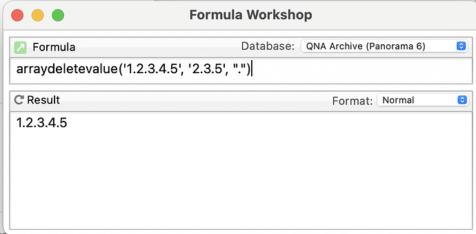

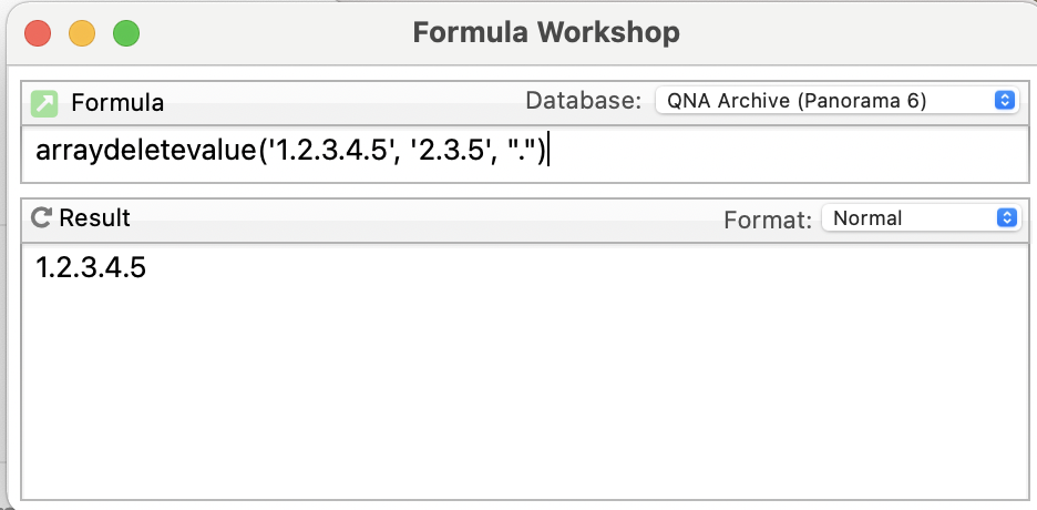

I hear you and Dave. I am just a bit bewildered at the moment because it is working for me as is. Something is odd and I’ve yet to figure out why it is working for me. In a bit of time, I’ll look further into what or why it is working as I need it to. Old code. Something is amiss. I appreciate the time you took on this. I was just first trying to figure out if the docs were less than complete.

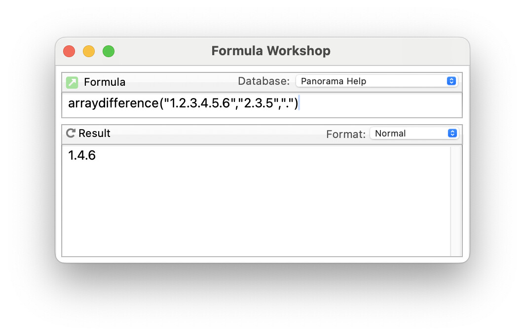

But … there is another way to do it, the arraydifference( function.
Luv that.
I am getting the results I want, just not clear as to how yet.
My description was incomplete. Before it looks for that string, it places separator characters before and after. It removes those extra characters at the end.
