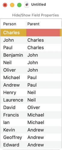

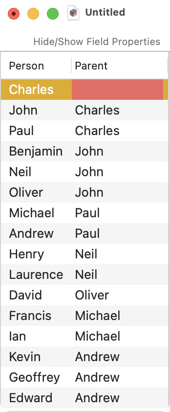

and from it make a database of each Person and his Parent:
then the Children of each Person would be an array of all the Persons in this database whose Parent is this Person. With a comma and space separating the Children, the formula for them should be:

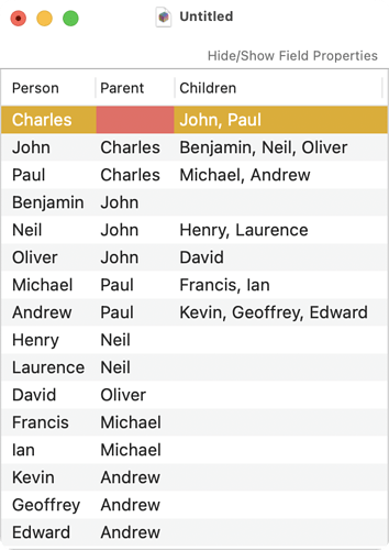

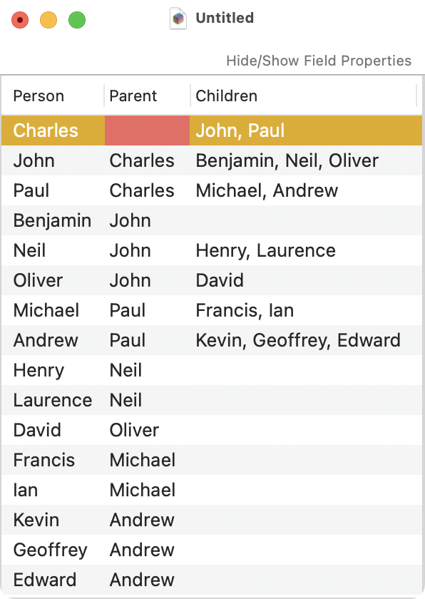

arraybuild( {, }, {}, {Person}, {Parent=fieldvalue("",Person)} )
then I get the result I originally wanted:
So why does this work using fieldvalue( but not the simpler ««...»» notation? Perhaps ««…»» doesn’t take account of the possibility that the database in question might be the current one, denoted by the empty string.
