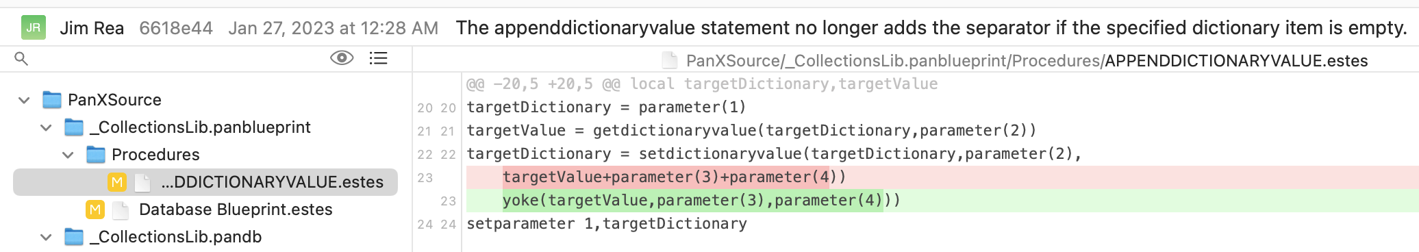

You do, but that kind of sucks. Starting with the b33 release, you won’t need to do that anymore, you can just append, append, append. Here’s the code change I just committed.
Here’s an example:
CleanShot 2023-01-27 at 00.30.47@2x
Here’s the linstrumentation log when this runs:
Yippee!
