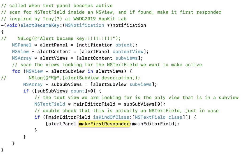

On the other hand, the advice to call makeFirstResponder: is correct. Here’s the code in Panorama that does this.
I’m kind of curious where ChatGPT got this information, since it didn’t get it from official Apple documentation. Just now I found ONE reference to this on the web, on a Stack Overflow post from 2019, a few months after my WWDC lab. However, I don’t think this is where this came from, because this post uses Swift, not Objective-C, and it says that makeFirstResponder doesn’t work!
So I have no idea where ChatGPT got this answer. Maybe from scanning a private code repo? (If it was a public repo, I think it should have shown up in Google.) In any case, this is an answer I already got from an Apple engineer, and also an answer that is around a decade old (the problem had already been occurring for at least a couple of years in 2019). Definitely not a Tahoe specific answer.
