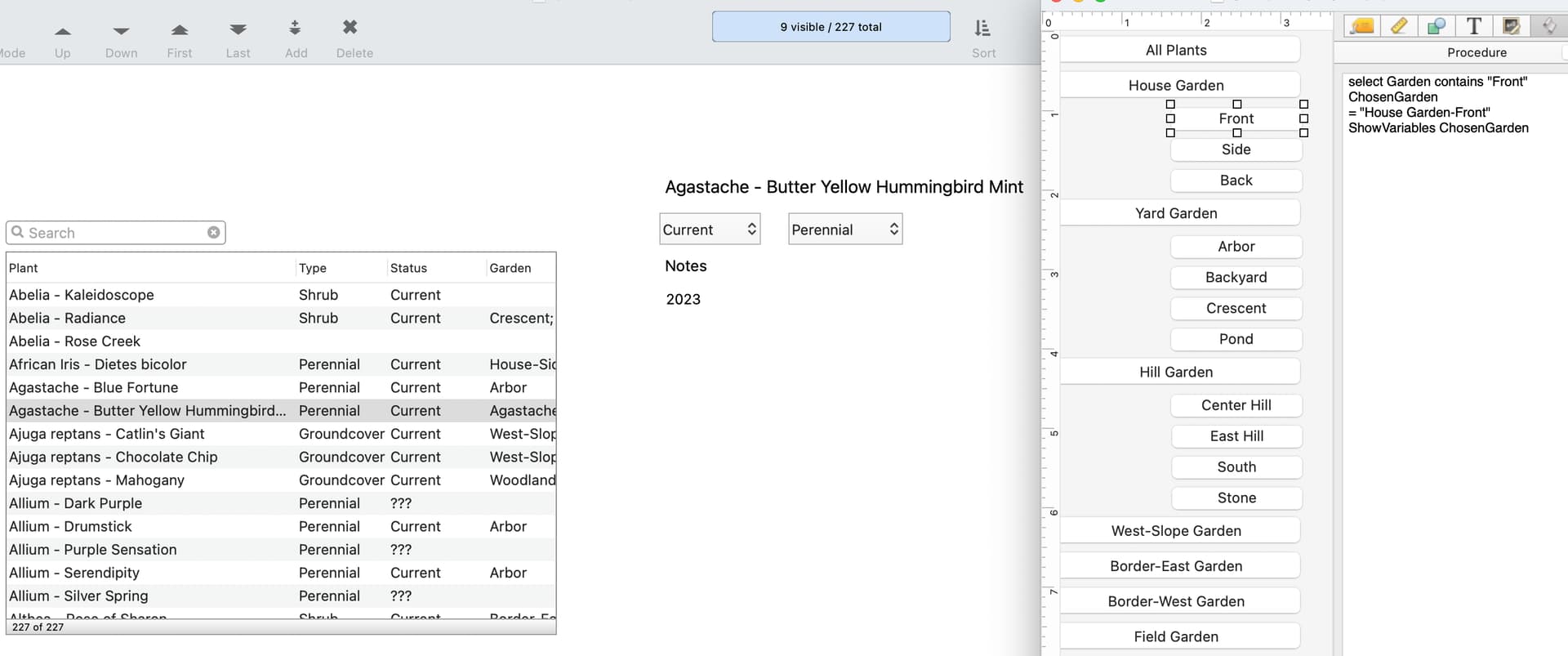

I made a TextList for my garden database on my PlantDetail form and it works well using the search box.
I have a separate form which has buttons that I can click to filter the found set for a specific garden.
Here’s what I’m trying to accomplish:
When I click on a button for a specific garden, I want the TextList on the PlantDetails form to only show those plants in the selected garden. I don’t want to use the search box at all (I know how to delete this search box). I do have the Database Navigator selected. The DataView is closed.
The example shows that I selected the Front garden which has 9 plant varieties. The TextList continues to show all 227 plants.
Any help is greatly appreciated.

If you want to set up the Text List to show a subset of the database, you have to set up the Query formula to do that.
You want to be able to change the Query formula with a button. That’s possible using the changeobject statement.
Actually since you just want to change the garden name, you could do it without the changeobject statement, you just need to have a fileglobal variable for the garden name. Set up this variable in your initialize procedure, something like this:
letfileglobal showingGarden = ""
Then in the Text List, use a query formula like this
Garden contains showingGarden or showingGarden=""
Then set up your buttons. The All Plants button should contain this:
showvariables showingGarden
The Front button should contain this code:
letfileglobal showingGarden = "Front"
If you also wanted to be able to search within the selected garden, you could modify the Text List query formula to look like this:
(import() contains searchText) and (Garden contains showingGarden or showingGarden="")
So with this setup you could easily look for shrubs in the front garden, for example.
P.S. If I was doing this, I would consider coalesching all of the push buttons into a single popup menu button with a list of all the gardens. This would make it simpler to code and I think easier to use.

Is there a way to automatically select the first record in a textList when changing to a new found set? ie - If the textList is showing all plants and I click a button to show only the Front garden in the textList, can it automatically select the first record? I have tried a few things but can’t find something that works.
There are several ways to make a pop-up in Panorama. The one I had in mind was actually using a popup button object, which would also automatically show you which option you had currently selected. But you could use the method used in the Propery Listing database as well.
Since you’re using the Database Navigator option, you would need the database to jump to that record using the find statement. For example something like this:
find Garden contains "Front"
By the way, if you used the pop-up button method, you wouldn’t need the first two lines, the object would take care of that for you. The last line would still be needed, but you would use slightly different code, probably
find Garden contains showingGarden
Actually, that line of code would work either way.
