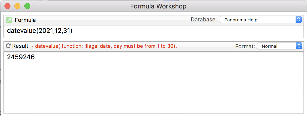

Today, I ran this procedure and found that datevalue( will cause an error when the months of August, October, or December are used. It does not accept the number 31 as a “day”. It does work properly when any of the other months with 31 days are entered, and it works with any of those months if “day” is set to 30.
This is the error message: datevalue( function: Illegal date, day must be from 1 to 30).

Confirmed. The error occurs in 10.2 (build 3860)
but not in 10.1.2

In fixing one bug, a new bug was created. In Panorama X 10.1, the datevalue( function would accept any day up to 31 for any month, even February. Panorama X 10.2 added better error checking, but didn’t do so correctly for the months August-December. Not only does it reject August 31, it allows September 31 with no error (of course the wrong value is calculated). It’s also wrong for October, November and December. I’ve just now added this to the bug list.
