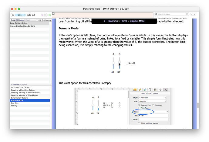

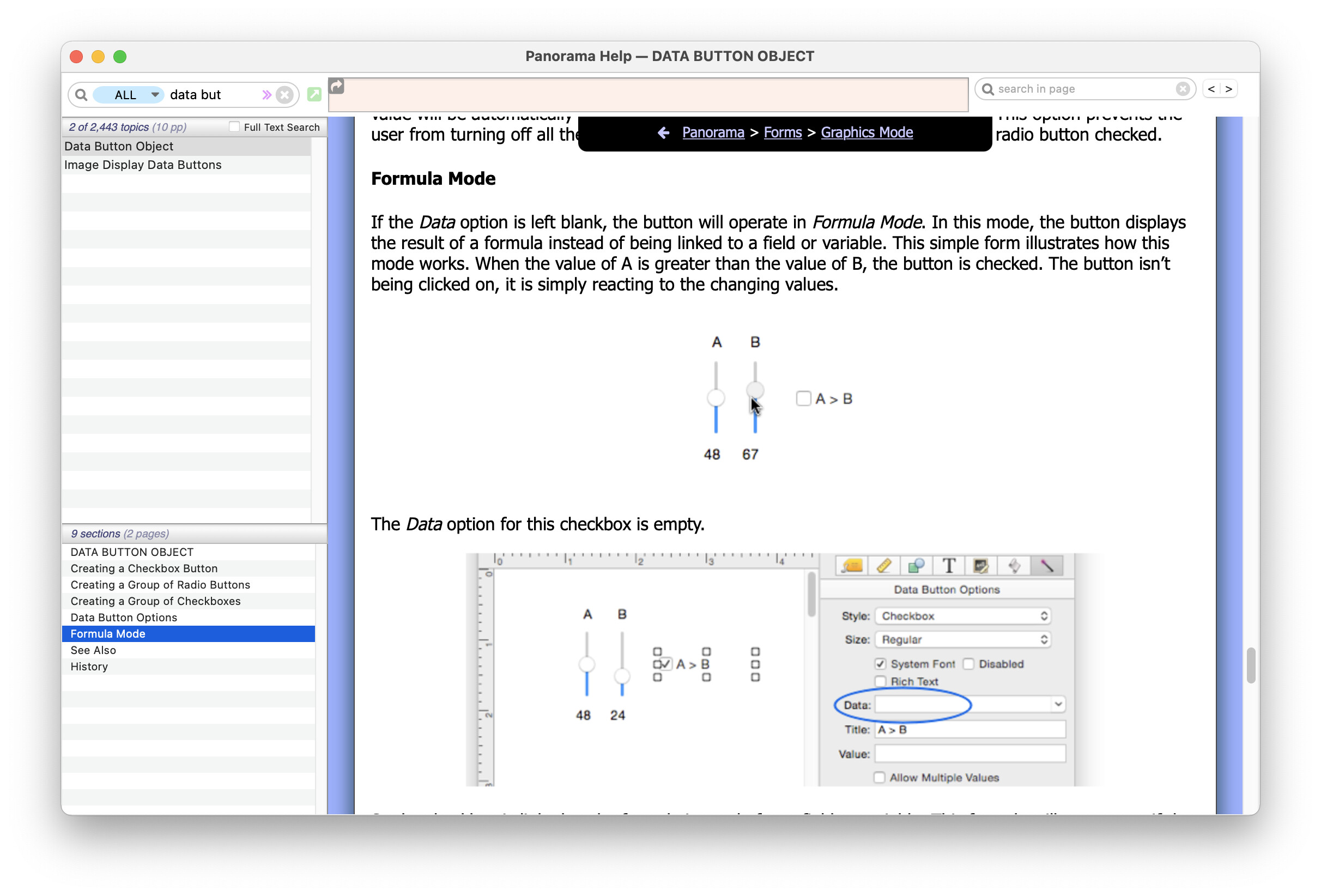

However, there is a way to do this - you simply have to use the Formula Mode option. This gives you full control over the operation of the button. You’ll find full documentation for this mode here:
Suppose you wanted the checkbox to toggle a variable called boxIsChecked with a boolean value (true/false). Create the data button, and enable Formula mode. Then set the formula to:
catcherror(false(),boxIsChecked)
